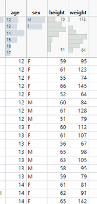

I'm not exactly sure sure if this is what you are looking for, but the data has to be in specific format for KS to work ( Re: non parametric KS test of two samples )
Data is is JMPs Big_Class sample data which looks like this:

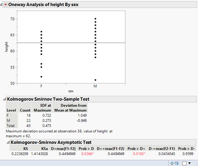

Script to run Kolmogorov Smirnov with height as response and x as factor
Names Default To Here(1);
obj = dt << Oneway(Y(:Height), X(:sex));
obj << Kolmogorov Smirnov Test(1);
Result:

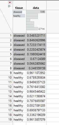

If this is what you are looking for, you might be able to add the reference data to same column as the the rest of data and then separate them in grouping column:
