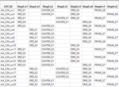

I have simulated such a case below where 20 lots have been processed through 4 process steps having step name changes.
For root cause analysis it is necessary to compare the probe results from equipment associated with a specific step. In the case below we can see that the data have become stratified.

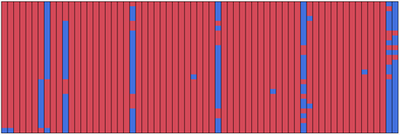

When using the Tables\Missing Data Pattern feature in JMP I can readily see the data structures and potential columns to be combined.
I was wondering if the information from the Missing Data Pattern could be used to script the combine columns requirement?

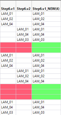

I had been using the script by @txnelson to build better data sets but then I realised that there is an instance where I would like to combine columns despite their respective missing data pattern (and complement) not matching. It is when both columns have missing data in the same rows.
Here is an example, building upon the original example :
I would like to combine columns associated with Step6 as seen above.
It then occurred to me that it would help to know the percent matching between columns prior to any data handling. This would  give the possibility to use such information when deciding whether to combine or not.
Having communicated with @txnelson he kindly developed his script.

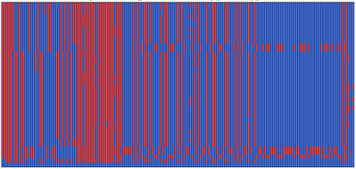

I am also including below some examples using "real" data where this method has been used to improvement data quality:
Note: Cells coloured blue denote missing data
Case 1:
From
 to
Case 2:
From
to
There is a vast reduction in the columns and much fewer "empty" cells
As you can imagine, this allows for improved, faster and more efficient root cause analyses.

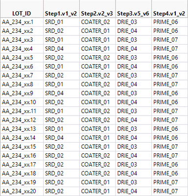

Thanks Jim for the very fast response and solution.
For those wishing to see your script in action I am including  the data building script from the example I provided and your JSL to report the columns which could be combined.

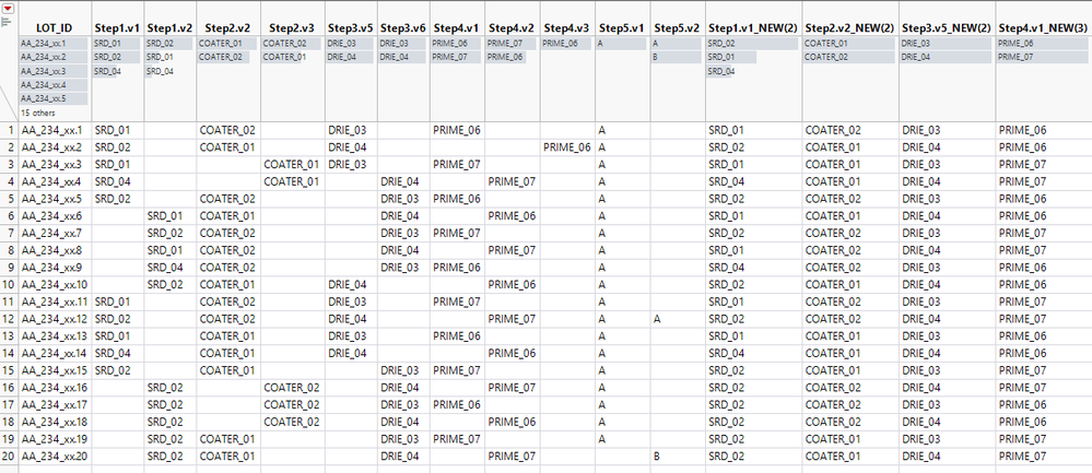

Went maybe a bit too heavy on scripting.. I didn't use Missing Data Patterns in this solution due to possibility of having more than 2 similar columns (not sure if it is the case here). Most likely these could also be detected with Missing Data Patterns but I made my own solution.
Result table:
New columns are created and old ones are left alone (could be easily deleted). Value in the new column name between brackets tells how many columns were combined to create the new column. Step5.v1 and Step5.v2 are not combined due to row 12 having same value twice. Should be easy to change by modifying function F_checkForInversePatterns in the script to allow columns which have matching data on same row.
This solution doesn't take into account how similar the data is inside columns (would require one additional check). Also column name similarity is simply checked if the Step name before period is same between columns.

Whilst evaluating txnelson's script on a much larger data table from manufacturing, it was found (Jim found) that if certain rows have no data in all targeted columns the script will not give an output listing. Jim has kindly provided a fix to the script. See below:
Names Default To Here( 1 );
dtRaw = Current Data Table();
colNamesList = dtRaw << get column names( string );
Remove From( colNamesList, 1, 1 );
dt = dtRaw << Missing Data Pattern(
	columns( Eval( colNamesList ) ),
	Output Table( "Missing Data Pattern" )
// Get rid of all missing and all present patterns
dt << lock data table( 0 );
dt << select where( Contains( :patterns, "0" ) & !Contains( :Patterns, "1" ) );
Try( dt << delete rows );
dt << select where( Contains( :patterns, "1" ) & !Contains( :Patterns, "0" ) );
// Check for columns which could be combined
//  *** JSL written by txnelson ***
cols1List = {};
cols2List = {};
For( i = 4, i <= N Cols( dt ), i++,
	comp = Associative Array( dt << get rows where( As Column( dt, i ) == 1 ) );
	compMissing = Associative Array( dt << get rows where( As Column( dt, i ) == 0 ) );
	If( N Items( comp ) > 0,
		For( k = i + 1, k <= N Cols( dt ), k++,
			comp2 = Associative Array( dt << get rows where( As Column( dt, k ) == 1 ) );
			comp2Missing = Associative Array( dt << get rows where( As Column( dt, k ) == 0 ) );
			comp2 << intersect( comp );
			comp2Missing << intersect( compMissing );
			If( N Items( comp2 << get keys ) == 0 & N Items( comp2Missing << get keys ) == 0,
				Insert Into( cols1List, Column( dt, i ) << get name );
				Insert Into( cols2List, Column( dt, k ) << get name );
nw = New Window( "Results",
	Outline Box( "Columns that can be combined",
		Table Box( String Col Box( "Column", cols1List ), String Col Box( "With", cols2List ) )
- Philip
