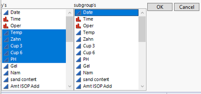

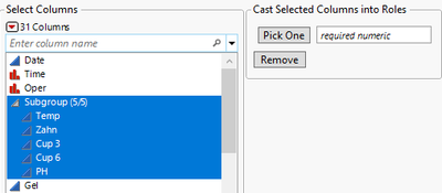

Is there a way to have a collistbox show column groupings?  they show up when you use a column dialog but just a list of columns with no grouping shows up when I use a collistbox.  Ideally I'd like to be able to stick with the collistbox if possible.
What I'd like to see:
what I'm getting:

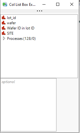

You can use the "Grouped" option on the Col List Box.
Names Default To Here( 1 );
dt = Open( "$SAMPLE_DAA/semiconductor capability.jmp" );
New Window( "Col List Box Example",
	Col List Box( all, width( 250 ), maxSelected( 1 ), grouped ),
	fontobj = lb = Col List Box()
It is documented in the Scripting Index
