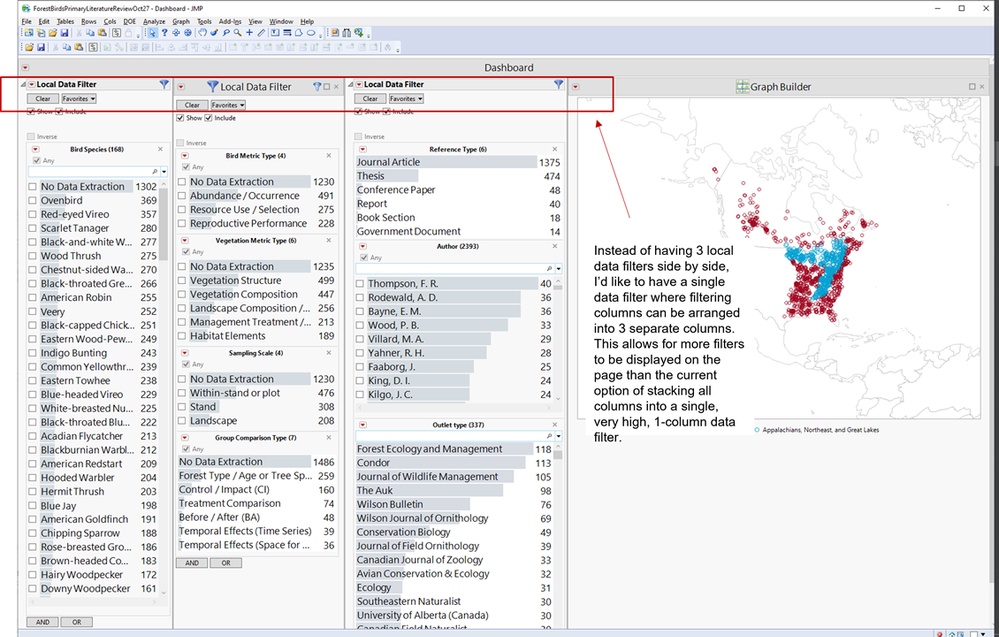

Hi again. Here is a second data filter configuration question... I'd like to use a relatively large number of categorical columns as data filters. Some of these have many levels. Currently, each time I add a column to a data filter it is appended below the last filter. This results in an impractically tall chain of filters that scroll well off the page (and don't compact well with scroll bars).
Instead, I'd like to create a wider display, with multiple columns, arranged in 3 columns, in a data filter. See image below and attached. This image is just a mockup where I placed 3 local data filters next to each other for illustration. I'd prefer to use only a SINGLE data filter (not local data filter), having the option of adding new filter columns into new display columns. This way, I don't have to establish relationships between multiple local data filters or between a local data filter and the data table. Again, thanks in advance for any recommendations. Casey

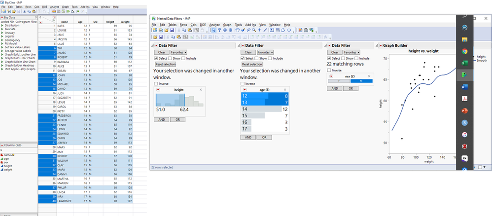

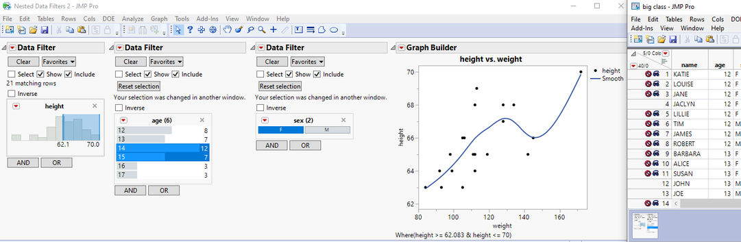

Thanks for the response. The problem with the horizontal chain of filters approach is that they no longer function as one would expect for a boolean query. Like you said, it is only the filter that was last touched that affects the selection. See below for an illustration. I first selected a subset of height bins, then two different ages, and then a single sex. If you look at the table you can see that, in the end, only the final selection (all male records) is registered.

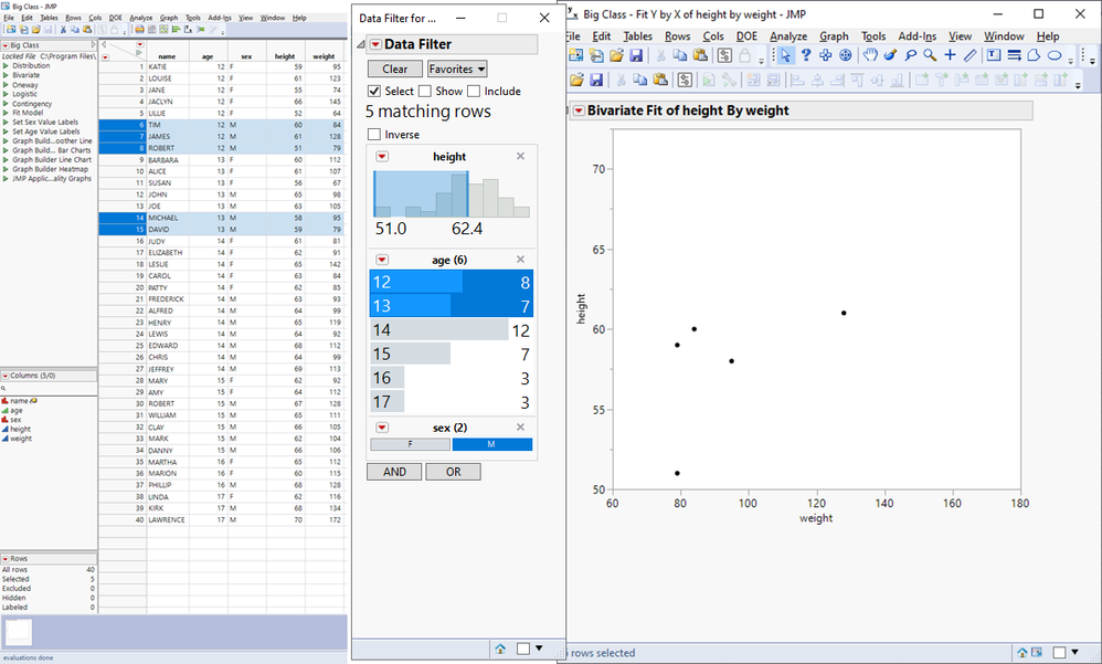

Now... If I make the same selection in a single, vertically oriented data filter, the boolean selection logic works as expected in that the points shown and data table records selected reflect all records that are below the height threshold AND one of the selected ages AND the selected sex.
This seems to suggest (unless I'm getting something wrong) that boolean queries are possible with a single vertical data filter, but not using a horizontal chain of filters. So, like you said, while the horizontal and vertical displays look similar, they do not function similarly.
