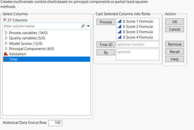

Is it possible to have timestamp or part-id on X-axis in the Model driven Multivariate control chart?
JMP Model-driven multivariate control charts are great but unable to use in our factory as a daily driver due to MDMCC X-axis doesn't have date-time or part-ids.
Can someone help how to add time/ID to the x-axis?
1 REPLY 1
Re: Is it possible to have timestamp or part-id on X-axis in the Model driven Multivariate control chart?
This should be possible to do by adding the column containing your Time stamps, or ID variable to the box labeled "Time ID" in the MDMCC dialog box.
Hopefully that resolves the issue, but if not, happy to help further as needed
