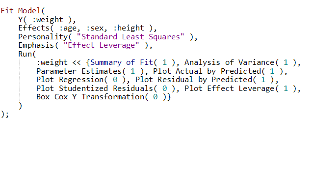

Also, the script that I acquire is spread horizontally across the script window. Is it possible to acquire the script vertically in the script window?
Re: Is it possible to extract the script behind a JMP Table?
You can reformat the script in the ScriptBox to make it appear nicely in the Script Window.
Window( "Script Window" )[Script Box(1)] << Reformat();
Justin
powerpuff
Level IV
This somehow doesnt seem to work. The output I acquire looks like this.cap.PNG
Whereas I am looking for something like this:
David_Burnham
Super User (Alumni)
right-click and select reformat script
