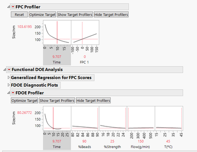

Sounds like you're in the right spot: FDE should be able to use the entire output/shape of your data, rather than just certain points.
I see the DFPCA option in the functional data analysis platform.
Is there a reason you're using that rather than fitting a model to your data? In my experience, fitting a model (Red Triangle...Models) is usually the first step. Direct FPCA is certainly an option, though.
[Is there] a way to do multiple data points and data series, and do PCA with all of it.
Yes. If I'm understanding correctly, you'd use either the FPC Profiler or (more likely) the FDOE Profiler. The FPC Profiler shows how changes in FPCs affect the shape of the output, and the FDOE Profiler shows how changes in DOE inputs affect the shape of the output. I've put a screenshot below and attached a sample data file.
