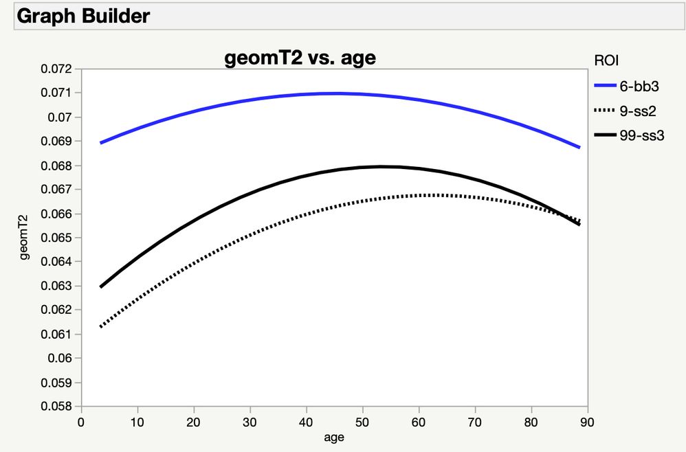

I would like to display both linear and quadratic fit lines in the same plot. Essentially a combination of the two plots I've attached to this post.
graph 1graph 1graph 2graph 2
Is this possible in JMP?

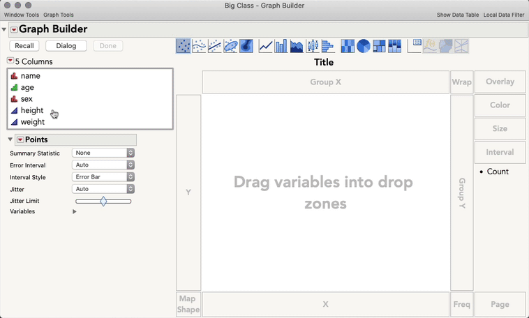

I agree with @Dan_Obermiller and @ian_jmp but if you really need to use Graph Builder, then the approach is to first fit the models separately and save each one of them as column formula. Then add these columns in the Y drop zone of Graph Builder. Now change the rendering element to Formula.
jules
Re: Is it possible to display multiple fit lines of different degrees in a single plot?
Hi @JonathanL,
This can be done in Graph Builder, if you would prefer to do it there. If you would like to display a second line element using a different degree, you'll need to add that second element, either by holding the shift key and clicking the line of fit element, or dragging the line of fit element into the graph after you've already selected it. Then, you can change the degree for this second line of fit element. Like every other element, variables in other roles are respected unless disabled, so if you have a variable in the Overlay role, both of these line elements will display lines of fit separately for the levels of the Overlay variable.
