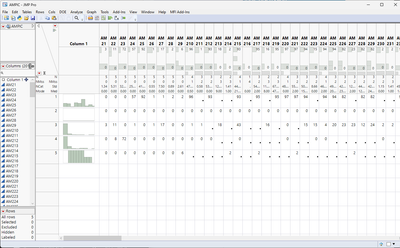

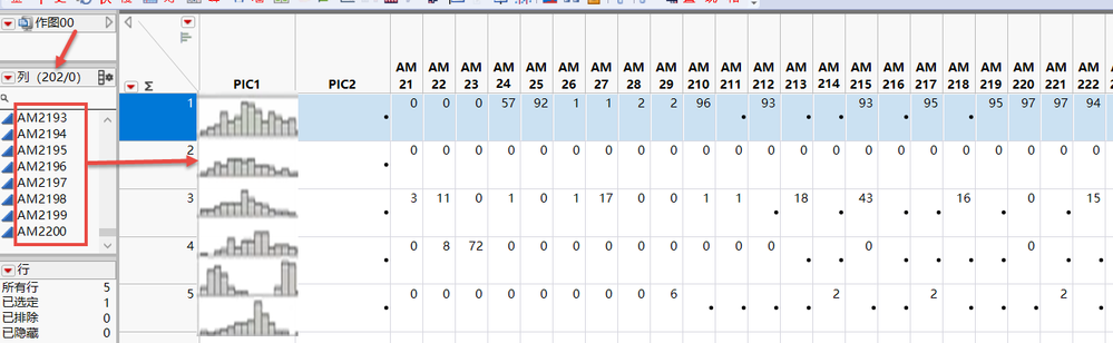

Is it possible to achieve this type of plotting using JSL?
Plotting in a specified column: Plotting data from multiple columns in the same row as a graphic within this column.
It seems the effect of the new column manager is not like this.

You can create the plot in graph builder, save the graph(s) as data table and join to your table

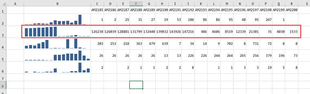

I wanted to have a quick way, easy like excel.
Of course, that's not the figure I showed above.It's just a schematic.

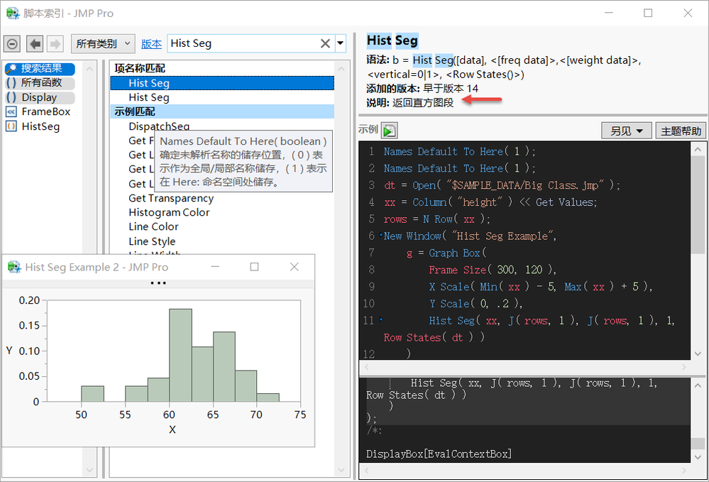

JMP does have Hist Seg which could be used in formula to build something like this

How can it be implemented with JSL?
jthi
Re: Is it possible to achieve this type of plotting using JSL?
You have great example how to create Hist Seg with JSL. Combine it with data table subscripting to get the values and finalize with << Get Picture on the Hist Seg (or some other method of turning it into picture)

I can't find this Hist Seg formula
How to use JSL can only be done in a loop step by step.
It's convenient if you can do it in a formula.

Looking at the Hist Seg application in this help is completely different from excel's graph, I need to use a row of multiple columns of data to create a graph

And you can for example use data table subscripting to access values row by row.
