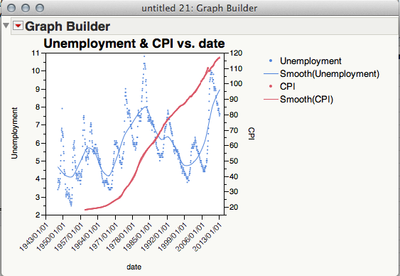

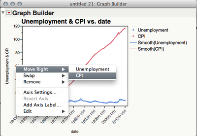

You can move one of your variables to the right of the Y axis to see two different scales.
Moving CPI to the right will give you this:

I actually meant 2 scales on 1 single axis, such as in your first picture, but with two different scales, with one scale at the left of the axis, and the other one at the right on the axis. And then, at the right of the graph, a secondary axis. But maybe that is not possible in JMP, and then you don't see anything anymore...

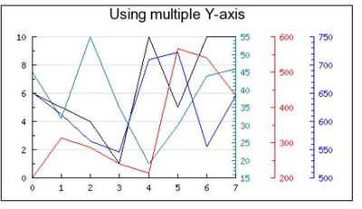

I was actually trying to draw such a diagramm, which Lucie asked you yesterday. I found an example for the graph with multiple x-axis which i would like to create:

Unfortunately, JMP doesn't have any support for more than two Y axis scales.
