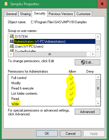

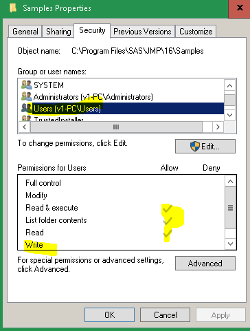

Here's what I see:
User PermissionsUser PermissionsAdmin PermissionsAdmin Permissions
I'm running as user, not admin, and folders without write permission have isDirectoryWritable==false.
