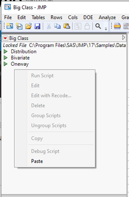

I just detected by coincidence a very cool shortcut along the idea: "stay in the flow"
If you copy a script to the clipboard (new column, report creation etc), you can go to another data table, right click into the table script menu and "paste" the code there. My first guess was that this generates a new Table Script with the code inside.
But much better:
It runs the code for the second data table, i.e. acts like the re-run script from Clipboard Toolbar Icon which @shampton82 presented in his talk (~ 19:50min.)
This feature I will use VERY often - many thanks for implementing it!

Very cool, thanks for pointing this out!
