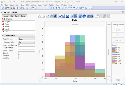

I replicated your findings.  It does appear that using drag and drop of the X axis for 4 variables with a histogram display in Graph Builder, does change the graph from overlayed to side by side.  However, if you stack the columns you want overlayed and then used the stacking group column as an overlay column, it will overlay more than 3 levels.

txnelson
Re: Intro to Graph Builder Distribution

txnelson
Dropped the column that shows what the original column name was into the Overlay drop area

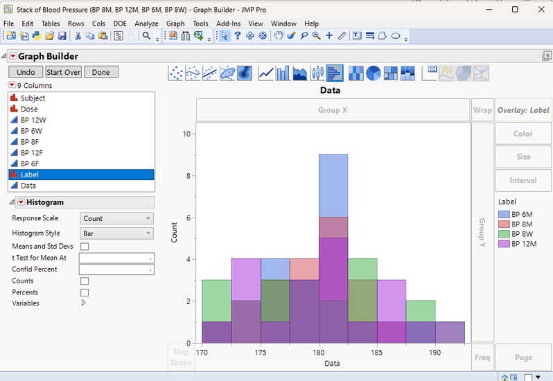

txnelson

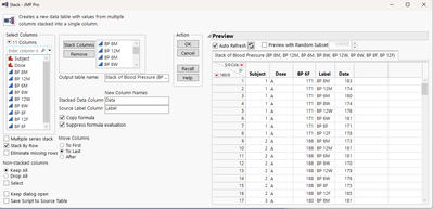

As an example:
Open
     Help=>Sample Data Folder=>Blood Presure.jmp
Stack the BP columns using
     Tables=>Stack
Go to Graph Builder and Drag the Data column to the X Axis and the Label column to the Overlay drop area and then click on the Histogram icon
Jim
