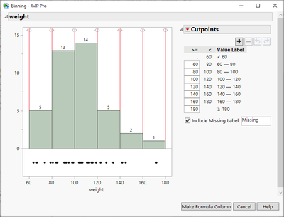

In the Interactive binning interface, in the bottom section (plotting points distribution),
how can I specify that jitter type ?
I know it's feasible, because it used to be jitter "packed" (i.e mandolin graph), but the default jitter looks to be a "uniform" jitter which is less useful for interactive binning.

You mean this interface (I'm using JMP17)?

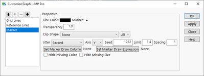

Right click on the area of graph where markers are, select customize, marker and change as needed
