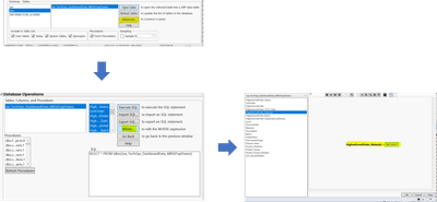

I have the following Question:
how can I generate an addition to the script that I use to pull data from a SQL database, in which I would like to replace the  Advance search function “Where” by an interactive Window in which the user types what he actually wants to pull, here eg 06C3020 so that only data is pulled that has this expression in a specific column (here HighestLevelOrder_Material)?
Here the resulting script for the data pull looks somthong like this:
Open Database(
"Description=Tracking Test5;DRIVER=SQL Server;SERVER=CWA565656P\SQLEXPRESS;UID=SVC-Tech-R;PWD=TestPW;APP=JMP;WSID=ADDDE1L5HS573;DATABASE=Tracking_and_Trending;",
"SELECT * FROM [dbo].[vw_TechOps_DashboardData_MB56TopDowns] WHERE dbo.vw_TechOps_DashboardData_MB56TopDowns.HighestLevelOrder_Material = '06C3020’”
