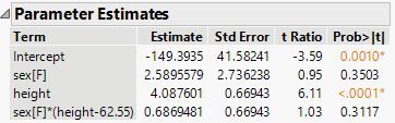

You must be using the Fit Least Squares platform to include a term for an interaction effect in the linear predictor. The Parameter Estimates report provides the estimate (slope), standard errors, and t-ratios. For example:
So the effect (slope) of height for sex=F is 4.087601 + 0.6869481 and for sex=M it is 4.087601 - 0.6869481.

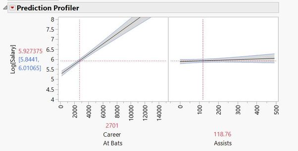

Re: Interactions in OLS regression and simple slopes.
Unfortunately I do not have the time right now to build the tests on the simple slopes. Perhaps someone else can help with that. One thing that I did notice on your attached picture is that your prediction profiler does not have the confidence intervals turned on. If you click on the red triangle for the profiler, choose Confidence Intervals. You should see bands show up like this picture:
Although this is not your data, notice the picture on the left. There is a horizontal line that is NOT within the shaded confidence interval. That variable (Career At Bats) is significant. The shaded confidence interval on the right completely contains the horizontal mean line. That variable is NOT significant. These are 95% confidence intervals and would be equivalent to conducting the test at the 5% significance level.
