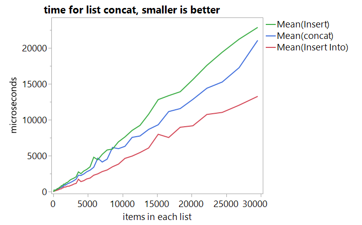

If you want a new list, leaving the old lists unchanged, the best choice between these
        lnew = l1 || l2 || l3;
// vs
        lnew = insert( l1, l2 ); lnew = insert( lnew, l3 );
depends on the length of the lists, though || eventually pulls ahead in the graph below.
All three are within a factor of 2 of the same speed. I like insertInto() because it avoids copying list1. I like the || concatenation operator because it is clear what it is doing.
InsertInto wins if you don't mind that it does what its name says.InsertInto wins if you don't mind that it does what its name says.
