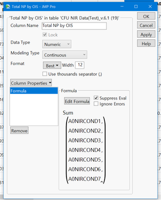

I am currently utilizing a simple function within JMP to leverage the Auto Refresh feature in JMP Live for dashboard purposes. However, while the function operates correctly on my PC, it does not work properly on JMP Live.
Even though I have disabled "Suppress Eval" before executing Data Publish, when I later download the data, the column where the function should be applied appears empty, and I can see that "Suppress Eval" is checked again in the Column Info. This issue has occurred since the recent version update.
I would appreciate it if you could investigate the cause of this issue. For reference, I am sharing the Refresh Script I am currently using.
Thank you.
