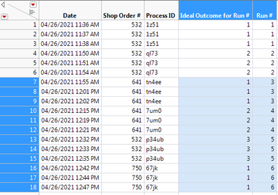

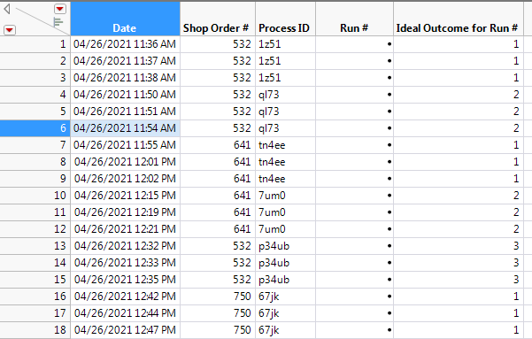

I am trying to develop a formula that increments up the Run #. It should count up for each time a Shop Order has a new Process ID and reset back to 1 when a new Shop Order has not been run before. As shown below the Shop Order 532 has 3 different Process IDs, but they are not in order so it still increments up to 3 on the final one even though it isn’t in order. I created a column manually showing what I would want as an ideal outcome for the formula column. How would I write a formula to deal with this issue?

Re: Increment a value for Run Number
Thank you for this. It doesn't quite do what I am looking for. See the mismatch between the "Ideal Outcome Column for Run #" and the "Run #". The way the formula is currently working is just incrementing up no matter if a new SO is started.

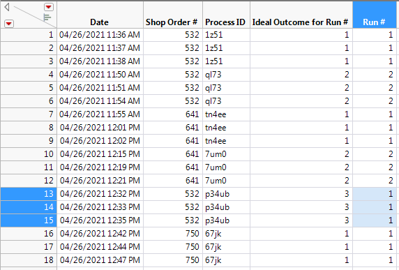

That was closer, but it restarted the count for Shop Order # 532 at 1 the second time that it was listed since there was another Shop Order between runs 2 and 3. The image below shows the highlighted cells where it deviated from the Ideal Outcome.
