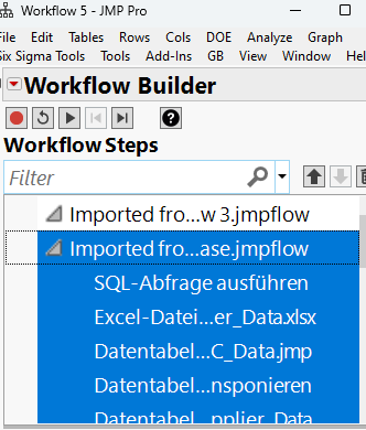

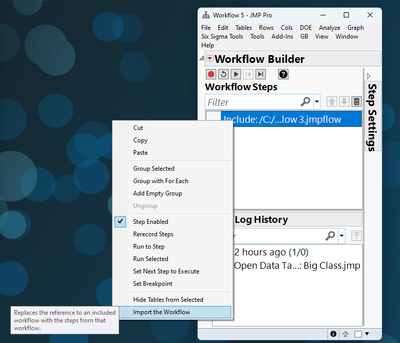

If I have a workflow included in another workflow
I can right click on the included workflow and import it, then in case there is also an included one, you can do it again
which would then (if it is the final sublevel open all steps of that included workflow:

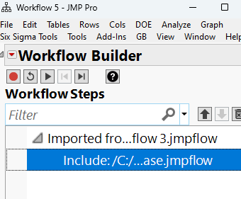

Hi Martin, I don't want to include the workflow, I want to open it - to make tiny changes and save it.
compare:
If there is an error in the included workflow, it stays open after JMP encounters the error.

ah got you, editing of the included workflow would be possible in my approach but not saving the changes I made back to the included workflow itself, just to the final workflow (incl. the included workflow). Agree it would be a nice option to "save included workflow" or "open included workflow outside workflow", of course with a better wording ;)
