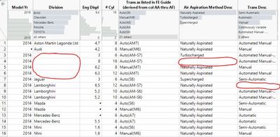

Hello, everyone.
I would like to know if it´s possible to impute data for nominal missing data.
I know how to do it for continuous data, but for categorical I did not find anything in the software.
Thanks in advance!
