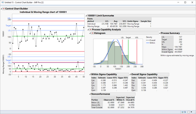

  Once the new measurement table is produced, and the limits loaded into the column properties, the control charts can be produced.  Please excuse my failure to center the actual sample data within the limits, but you can see that they are there.
