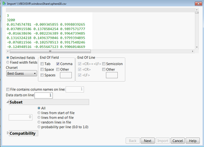

If you had a CSV file, text import offers some subsetting choices.
I think there are similar options in other import tools in JMP.
