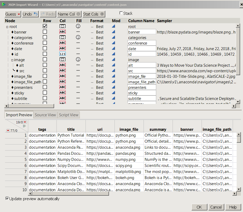

Anyone landing here for JMP 15 and beyond: there is built-in support for reading XML and JSON data that includes a GUI-based wizard. (JMP 14 has non-GUI support for JSON as well).
The wizard looks similar for both XML and JSON filesThe wizard looks similar for both XML and JSON files
