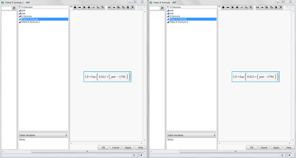

        However, if I try to run a second model on the same  data table , the column that gets added after launching the Non Linear Platform for the second time has the old model's equation.  Please see the sample code below :
Clear Log();
Clear Globals();
dt = Open( "$SAMPLE_DATA/Nonlinear Examples/US Population.jmp" );
/* Run Predictions using different models*/
PowerFitPredModel = Nonlinear(Y(:pop),X(:Name("X-formula")),"Model E(2P)");
PowerFitPredModel << Save Prediction Formula ;
PowerFitPredModel << Close Window;
Wait(0.1);
CPredModel = Nonlinear(Y(:pop),X(:Name("X-formula")),"Mechanistic Growth Model(3P)");
CPredModel << Save Prediction Formula ;
CPredModel << Close Window;
         Now, a couple of things that I don't follow are :
  1. When I launch the Non Linear Platform multiple times, why is only the first model equation that I call being applied in the above script ?
  2. How do I determine if the parameters that JMP is assuming to fit the model are yielding a solution that converges ? image.png
Best
Uday
