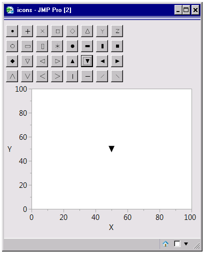

Craige_Hales
Re: Icons of the Graphic Markers
see https://community.jmp.com/t5/JSL-Cookbook/Custom-Button-Icons/ta-p/50294 , thanks for the idea!
button iconsbutton icons
Craige
