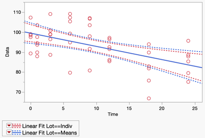

In the figure below I have 5 replicates for each time point and I've fitted a line to both the Individuals and the Means of each time point.
Note that the slope and intercept is the same.   (Its hard to see because the red and blue regression lines are right on top of each other.)
However, the confidence intervals aren't the same. The interval for the means (blue) is wider than individuals (red).   Why?  When we fit the individuals we get 39 degress of freedom (40 points -1), but when we fit the means, we only have 7 degrees of freedom (8 points -1).
This has an impact on when the lower 95% confidence interval crosses the lower spec limit. The individuals will cross later than the means. (longer dataing with individuals than means).   I'm sure you're thinking, "Why would anyone use the means over the individuals?", that's a no brainer right!  There is a problem with this, some of the individuals from early time points might be below the lower spec limit, and that would cause some sever problems with releasing the product.   Since we acknowledge that the assay is really noisy (really typical of biologics) then when we take the mean of the replicates for the reported time point result, we avoid this problem.
Also, each time point is one experimetal unit, and its nearly always appropriate to take the mean of replicate measure for one experimental unit.
In the script attached below is an example generator for the figure above.
