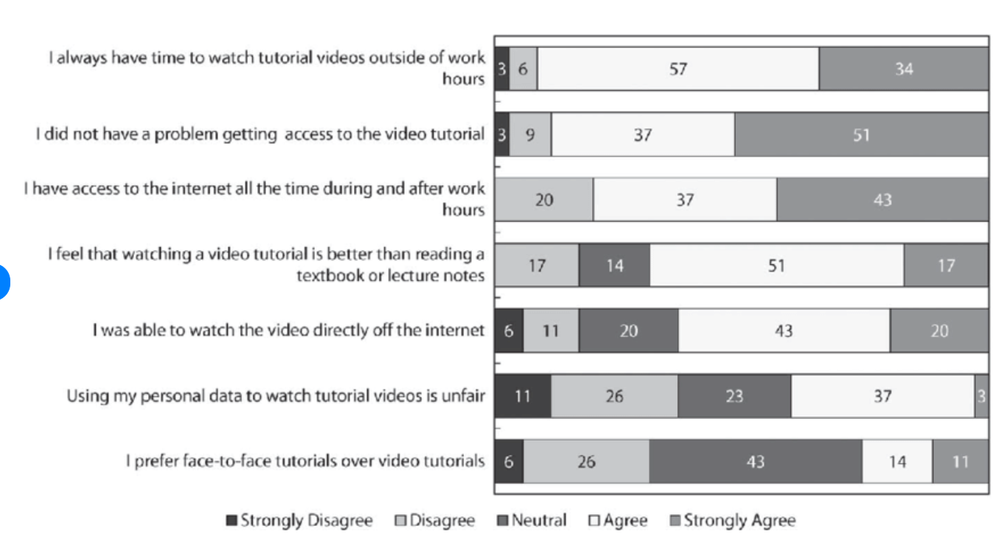

I would like to Display A Survey Results using a Horizontal Bar 100% stacked chart in jmp
for example as presented in the following  image
How do I create this?

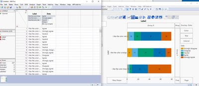

Depending on your data (you might have to stack it), you should be able to plot it easily using graph builder
-Jarmo

What is rhe recommended graph legend setting color for black and white publication?
