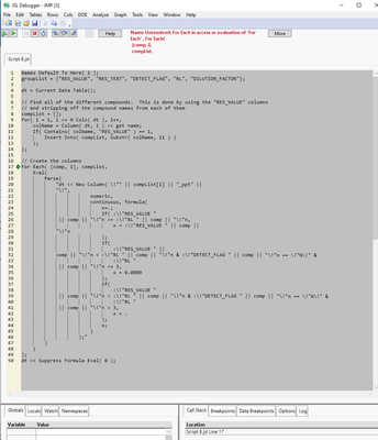

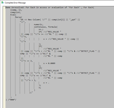

Thank you Jim.  I've meant to circle back shortly after your reply but have been trying to dubug the code.  I have not gotten it to work for some reason.  I used the debugger and got this message:
Just wanted you to know I received your input - I will keep trying.  Thanks.
