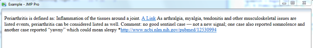

Combining @Byron_JMP's Web Browser Box idea with your regex string you could save a formatted html file with embedded links and display that in your window.  Suddenly you have a lot of control over the text formatting; you could even let users optionally add a friendly name to links syntax like [JMP Website]http://www.jmp.com, similar to some markup syntax.

Note the unfortunate slash bang in the regex match expression as "\[" begins an 'escaped character' section.
Edited to add screenshot and again to fix a typo.
