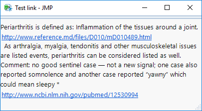

Thanks for your comments and suggestions so far.  I don't have the luxury of knowing where the URLs are in the user comments.
Here's some sample output:
Here's some sample code.  I made it easy by using URL "markers" <l> and </l>.  I've been playing around with URL location using regex to avoid having to use these markers.  If anyone has a good regular expression for finding URLs let me know.  I'm having varied success with what I've found on the net so far.

nw = new window("Test link",
	vb = vlistbox(
for(i = 1, i <= nt, i++,
	tb[i] = text box(text_list[i], << set width(400));
	vb << append(tb[i]);
	if (i < nt,
		one_button = evalinsert("\[lb[i] = button box("^link_list[i]^", web("^link_list[i]^"), << underline style(1) )]\");
		eval(parse(one_button));
		vb << append(lb[i]);
