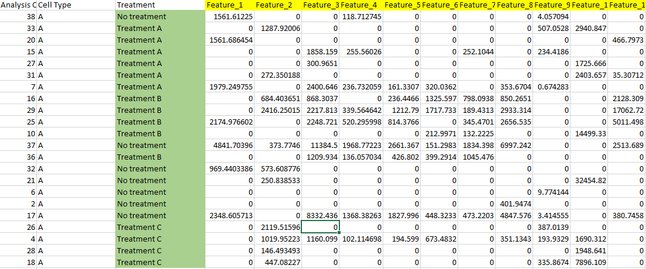

Hi all experts,  I am an user of JMP. I am writing to learn how to write a script to caculate Wilcoxon rank-sum test results for thousands of features. The tables of grouping and features(from feature_1 to feature_n) are attached as the figure above. Here is what I am going to do:
1) Wilcoson rank-sum test for "Treatment A vs. No treatment" for feature_1 to feature_2000. I understand I need to use "fit Y by X" funtion. The X should be the grouping (Treatment); and the Y should be the value corresponding to feature_1, 2....n.
2) I understand how to it mannully. The code for each feature is kinda like this:
  Fit Group(
 Oneway( Y( :Feature_1 ), X( :Treatment ), Wilcoxon Test( 1 ) ),
However, I don't know how to write a script to let it pick up the column items only have "No treatment" and "Treatment A"; and how to make it run as a loop to finish feature 1 and then feature 2 and till feature 2000.
I have tried my best to read the scripting guid. However, I can only catch the basic concept and don't really can make it solved. I will be really grateful if anyone here can at least give a hand here.
Thank you so much..
Best,
Windermere
