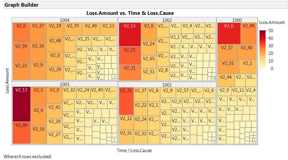

I'm partial to Tree Maps when trying to display this type of data, they pack a lot of info into a small space:
Although not necessary to create the above visual, your rank column could be used to subset the table to the values 1 thru 15 and then combined with the data filter you could answer the specific question "how do the top 15 causes change with time":

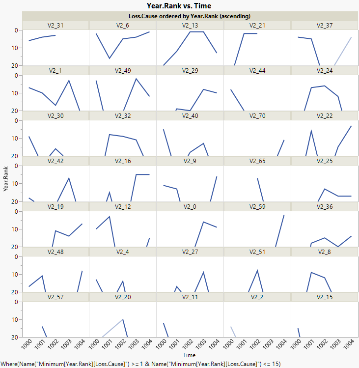

1. It's hard to beat line charts for changes over time.Below is a small multiples view of all the causes that ever make the top 15, ordered by the average rank. If you use a Group X instead of Group Wrap, you would get a layout similar to your bubble view.
2. I think the formula could be simplfied to Col Rank( -:Loss.Amount, :Time ).

markschahl
Level VI
Re: How to visualize change in pareto rankings over time
Jerry:
Thanks! Sorry for the delayed reply, was busy with meetings last week. I took your idea of using a treemap and made one change since V2 values are text strings of up to 20 characters: I used Color Theme Spectral. This made it really easy for the eyes to compare the rectangles for a given V2 value from one time period to another.

markschahl
Level VI
Xan:
Thanks! Sorry for the delayed reply - was in meetings all week. I like your solution! As we work on improvements, we always ask "Is last year's #1 problem still #1 this year?" The #1 should go down in rank (move to the right on a pareto chart), or if still #1 should get smaller. The line chart is a great way to see change in rank. Combining the line chart and Jerry's treemap solution (which shows the magnitude of the losses) really helps tell the story of where we are making progress.
One question: was the script your posted created only by point-click in GraphBuilder or did you have to edit the Save to data table script?
I'm looking forward to using a Local Data Filter for time and JMP14 Packed Bars to re-analyze this data!
XanGregg
Staff
Great, Mark. It was all point and click. The only tricky part was adding the transform column in the data filter.
