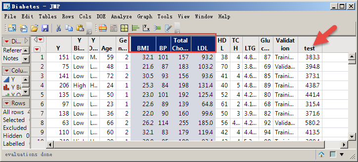

How to use the formula row by row to find the dynamic change of the total number of columns.
Such as setting:
The number a is the number of starting column positions that need to be summed
The number b is the total number of columns that need to be summed
dt = Open( "$SAMPLE_DATA/Diabetes.jmp" );
dt << New Column( "test", formula( As Column( 6 ) + As Column( 7 ) + As Column( 8 ) + As Column( 9 ) ) );
dt << run formulas;
Column( "test" ) << deleteFormula;
Such as:
A = 6;
B = 4;
Find the sum of columns 6, 7, 8, and 9 in the new "text" column (starting with column a, total column b).
Thanks!

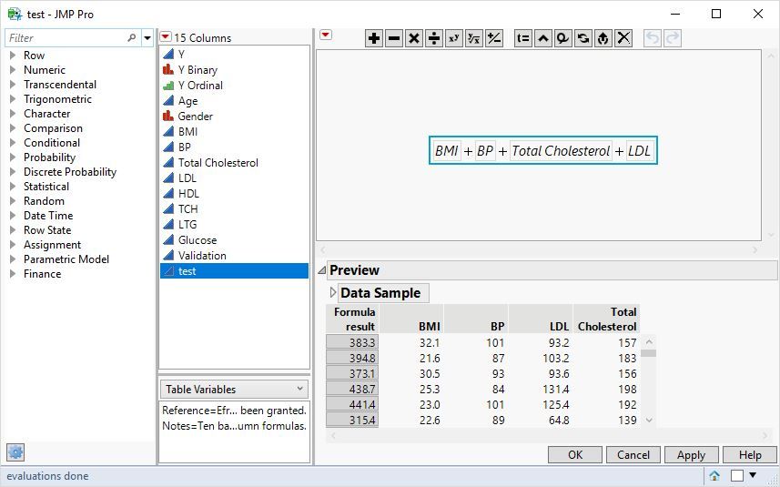

Re: How to use the formula row by row to find the dynamic change of the total number of columns.
This situation is weird. This script builds the formula:
Names Default To Here( 1 );
col = dt << New Column( "test" );
lo = 6;
hi = 9;
f = Expr( Add() );
For( c = lo, c <= hi, c++,
	r = (dt << Get Column Reference( Eval List( { Column( dt, c ) << Get Name } ) ))[1];
	Insert Into( f, r );
Eval(
	Substitute(
		Expr( col << Set Formula( fff ) ),
		Expr( fff ),
		Name Expr( f )
But it does not evaluate. Yet it works if I examine the preview in the formula editor.
Anyway, why use a formula when you don't want to?
