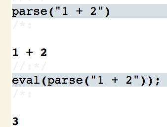

As with anything good there are many ways to approach a problem using the right tools.  As you mentioned a Substitute() is a great option as well when things start getting more advanced.  Substitute is especially useful in combination with Parse() which turns strings into JSL code and Eval() which then allows the JSL to be executed, this leads to Eval(Parse(Substitute())) statements.  This final technique is particularly useful when wrapping functionality around built in JMP platforms.  To further illustrate the combination of parse() and eval(parse) I've included a simple example.
Happy coding!
