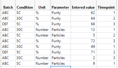

Constructed data table (Real ones have much more columns and rows):

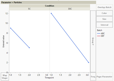

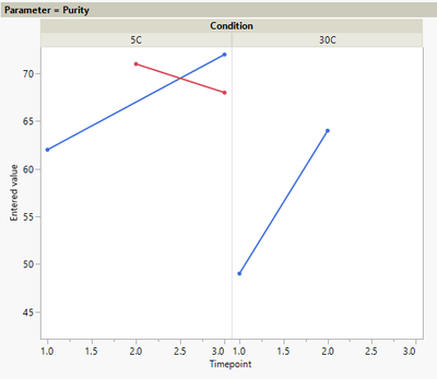

Corresponding simplified graphs - one for each parameter:
On the left is the Y axis label. It is automatically called "Entered value" corresponding to the header of the column containing the values. I would like the Y axis to not be called "Entered value", but use the text from the "Unit" column; Here it would be "Number" for "Particles" and "%" for "Purity".

Column "Entered value" contains numerical values. These are the Y values for each timepoint (on the x axis).
Column "Unit" contains Units described in text. All I want from this column is to take the text and use it as Y axis label.
Unit is different for each parameter (see the example table), so the "Entered value" column name cannot have all these 100s of unit names as column name.
