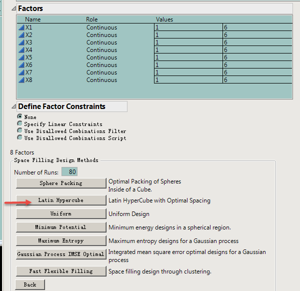

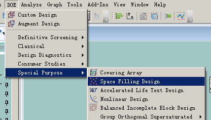

I'm trying to find "Latin Hypercube ", found in this action menu, but I don't know how to do it.
Thanks!

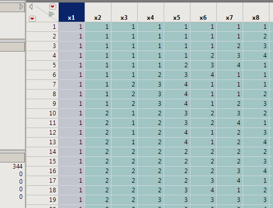

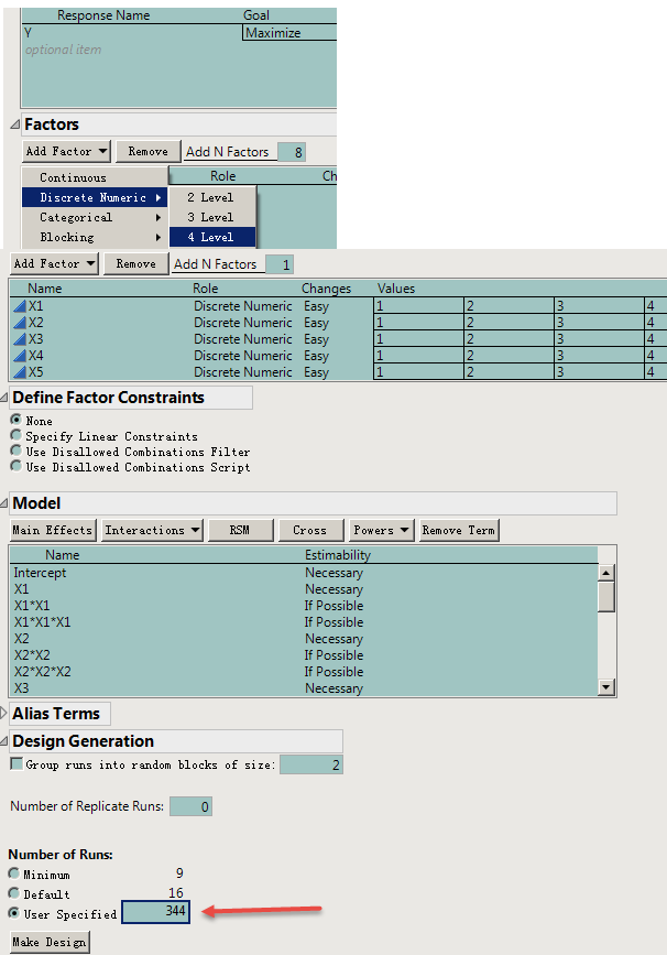

I directly used "Custom Design" to make 344 experiments of 8 factors and 4 discrete levels with different results.
