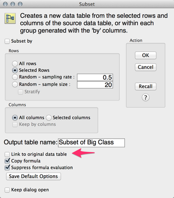

Hi sfkeydel,
When you create the subset you can choose to have it linked or not.
Is there some other process/script that you're not in control of that is creating the subset?
If you've already got a linked subset the only way to unlink it is to save it to disk, close it, and re-open it.

Hi Jeff,
Thanks for this. My specific use case involves using the Data Filter, and then choosing "Show Subset" via the red disclosure triangle; in this instance, I don't see an option to link or not. However, your recommendation does the trick.
