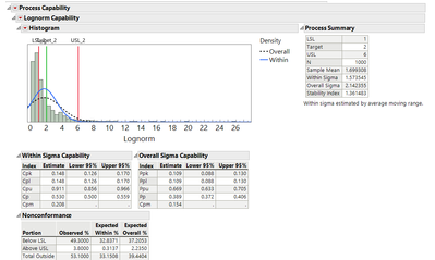

Original data: (lognormal)

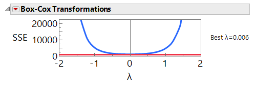

The Box-Cox transform (lambda almost 0 since the original data was a lognormal dist)

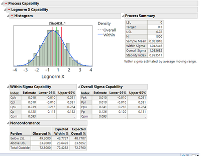

The transformed data with transformed (wrong) spec limits: (notice the different ratio of data inside and outside of the spec limits)

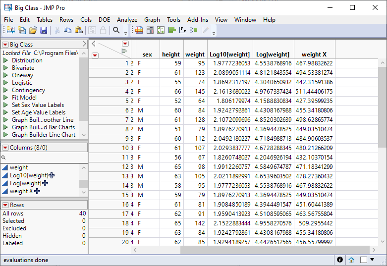

Here is an example using Big Class. You can see the original weight, Log base 10 of weight, natural log of weight, and the Box-Cox transformed weight using lambda = 0.

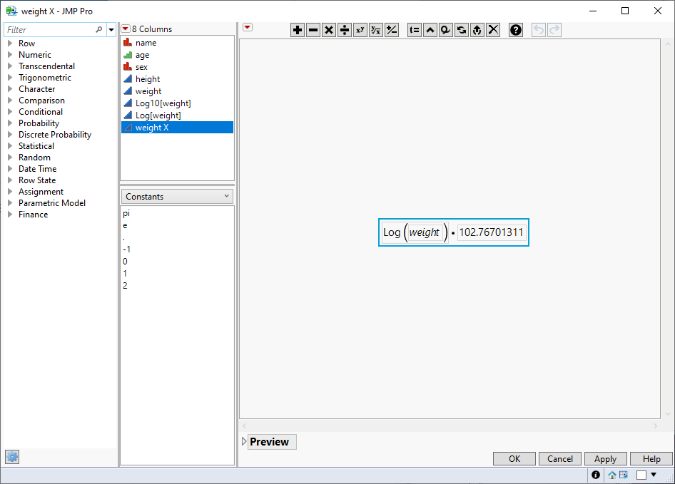

Here is the formula saved for the Box-Cox transform of weight from Fit Least Squares:

I wrongly believed that JMP simply uses the transform: y = (y^lambda-1)/(lambda) [1] for the data, and thus i used this for the spec limits as well. Using your tip i looked at the formula for the transformed column, and using this I get the correct transformed spec limits (with the same ratio of data inside and outside of the limits for the transformed and non-transformed data).

Computations set by JMP are simplified when possible for speed. The special case is faster than the general solution.
Also, function [1] above is only valid when lambda is not zero. Here is the transform function from the JMP Documentation for this transform:
Notice that the transformed response is the geometric mean of the response times the natural logarithm of the response when lambda is 0.
