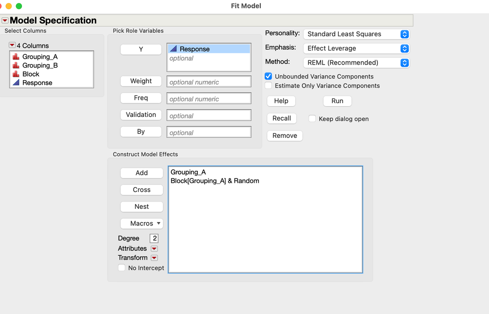

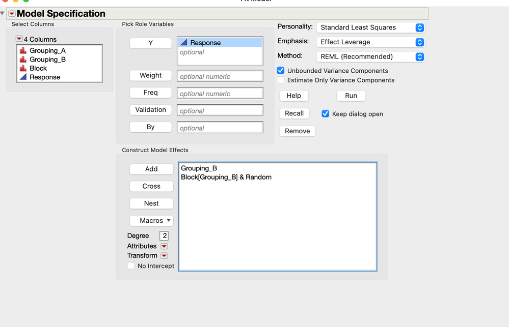

Hello!
I have also attached below some dummy data and screenshots of model formulationsScreen Shot 2024-05-08 at 3.08.32 PM.pngScreen Shot 2024-05-08 at 3.06.31 PM.png following the structure of the two models I am trying to compare below. I'm looking for a place to switch from Restricted Maximum Likelihood Estimation (REML) to Maximum Likelihood Estimation (ML) for AIC comparison
Thank you!

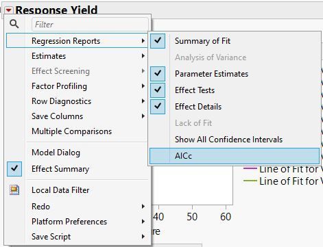

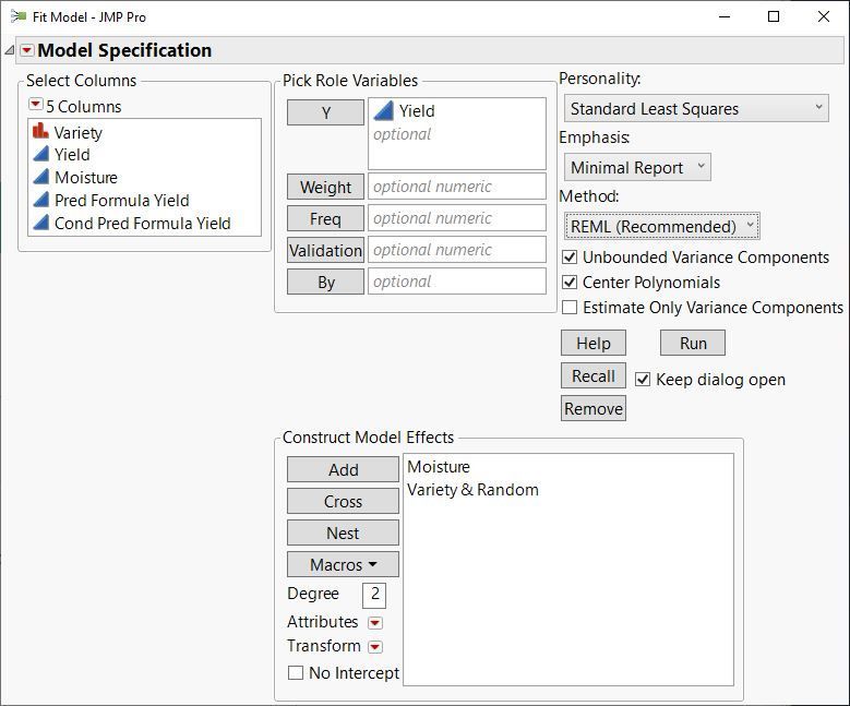

I do not see why you need to use ML instead of REML to estimate the model parameters and compute AICc. I used another example from the JMP Sample Data Folder, Wheat.jmp, and set up a similar model:
Click the red triangle at the top and select Regression Reports > AICc:

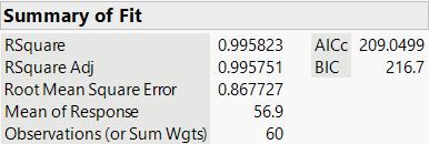

This criterion is added to the Summary of Fit outline:
