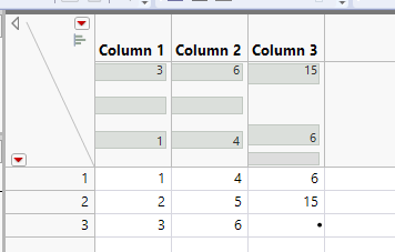

Hi,
I have a DOE setup where the names of the columns change.  Is there a way to sum the values in column 1 and put them in Column "Total Volume" row 1, then sum column 2 and put them in "Total volume" row 2, etc?  Thanks.

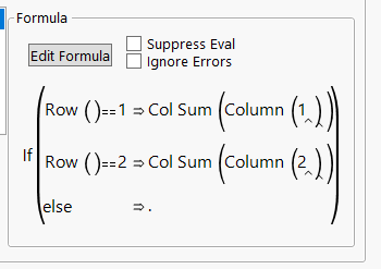

It is possible but it isn't really something you should do with JMP as JMP table isn't a spreadsheet(JMP is Not a Spreadsheet ). Below is example formula to give an idea how it could be done
If(
	Row() == 1, Col Sum(Column(1)),
	Row() == 2, Col Sum(Column(2)),
-Jarmo
If(
-Jarmo

Thank you this answered my question.  And thanks for the link to JMP is not a spreadsheet.  I've never seen this before and I do try to use JMP as a spreadsheet too often

I think I may be misunderstanding what you want.  But it sounds like using Table-Summary and asking for the sum of the relevant columns will give you what you want.  You can then make it into a data table.  If you need to have it placed in the original table with each row a different sum of columns, then you probably need to do something else.
