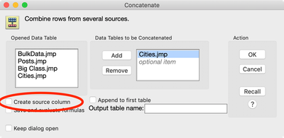

Now, having said all of that, there aren't many cases where you need the name of the data table in all the rows of the data table as JMP will create columns like this in the cases where they are handy. For example, when concatenating data tables, there's an option to create a column with the name of the table that each row comes from.
Other table manipulations commands have similar options. So, perhaps you can tell us what you're trying to do that you feel you need this column and we may be able to help you even further.
