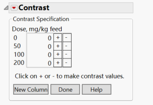

Hi there,

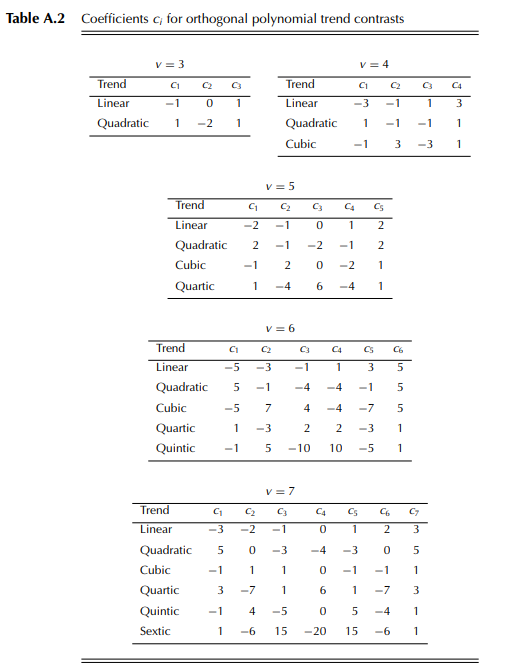

I recently bought JMP 15.1.0. Very different to SAS which allows me to use IML procedure to generate the orthogonal contrast coefficients for both equally and unequally spaced treatments, I got this dialogue box to click the + or -. It's easier to construct simple one-on-one comparisons by assigning +1 to one and -1 to another. But what if I want to construct a linear and a quadratic contrast with the doses shown below?
Even with equally spaced treatments, it's very hard to key in values above 2, such as the series of -3 -1 1 3 when v=4 (Orthogonality binds the values in a series: one change changes all). What are the rules for clicking the + or -? Is there a direct way to just key in the coefficient values in JMP?

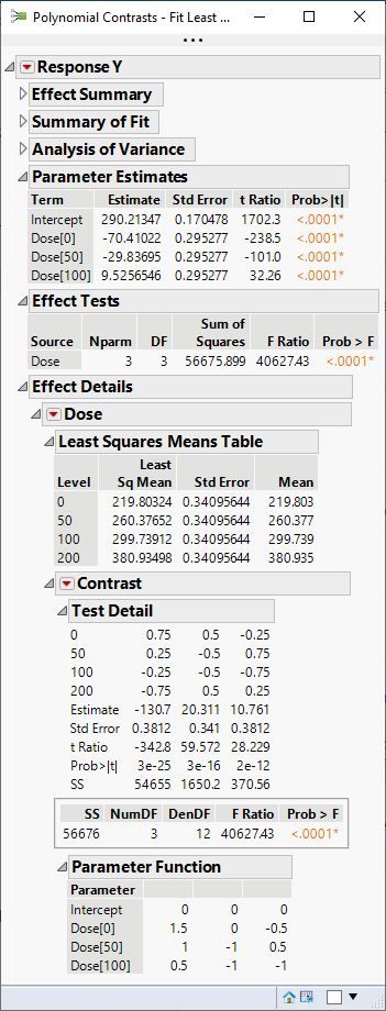

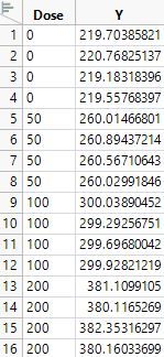

Let me confirm the answer by way of an example. I mocked up a similar situation: one categorical factor with four levels. It looks like this:
Then I fit the one-way ANOVA model and test the three contrasts:
The Test Detail report shows the final values for the Linear, Quadratic, and Cubic contrasts. They were achieved by clicking the + or - buttons in the UI. The coefficients from your tables are the number of times to click the button.
NOTE: I just realized that I got the signs reversed for the first contrast (Linear) but it should not change the test result.

1) if we want to click in a series of -5 -3 -1 1 3 5 for linear effect with 6 variables (equally spaced), does that mean I need to click - sign 5 times, - sign 3 times, - 1 time, + 1 time, + 3 times, + 5 times from top to bottom to get the serial coefficients for the contrasts even though they might look different?
