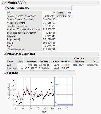

First, fit the AR(1) model and here is the report:
I include the script in your original data and attach the updated data table.

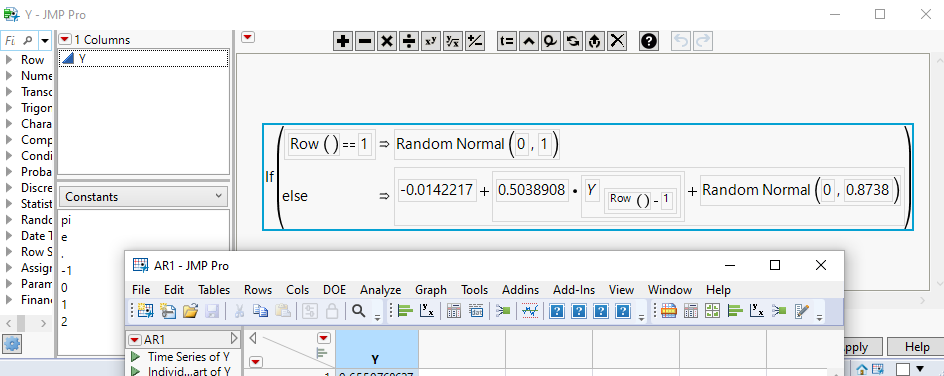

Next, create a formula column like the following. You need three numbers from the previous report: two parameter estimates, and standard deviation in Model Summary. And see how they are used in the formula.
Now a little about this formula. First imagine how a JMP table evaluate the formula, it is row by row. So the formula says, if it is the first row, just simulate some number according to the sample, here looks like a random Normal(0,1) fits the bill. Then as the row number increases, the formula calculates new values recursively based upon the value from the previous row. This is what that subscript of Y does.
