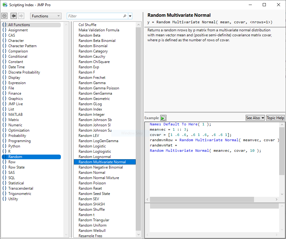

There is a function for this purpose:

Thanks, @Mark_Bailey for the suggestion.  This seems like it should be exactly what I need, but I'm afraid I'm having trouble figuring out how to properly implement it.  To start with, I would just like to generate one simulated column in a data table.  I know the mean, overall process standard deviation, within sigma (control chart sigma - which in this situation is based on the moving range), and the "Autocorrelation" value (from the summary statistics in the distribution platform).  I can also get a Correlation value for the process parameter against the Lag() of itself (by one row) from Fit Y by X - and I could repeat the correlation analysis for different row lags.  Any chance you could help me understand how I should structure the formula given the information I have (or let me know if I am just missing the boat entirely)?

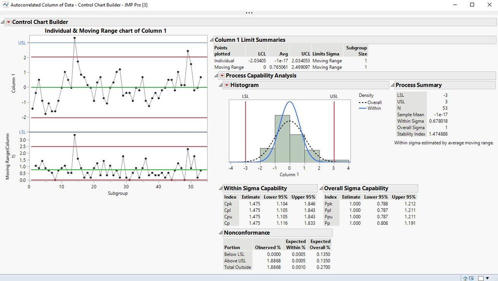

Thanks, Mark.  If it helps, at all - here is an example of the type of data I am trying to simulate.
