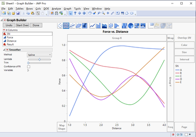

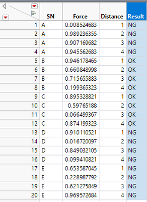

This is the data table, which concatenated by different SN, and I am going to see the difference of the result of curve plot by Force and Distance between different SN.

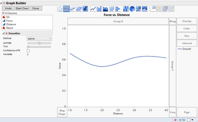

1st step:"Distance" vs "Force"
step 2: overlay by "SN" to see the curve for each SN

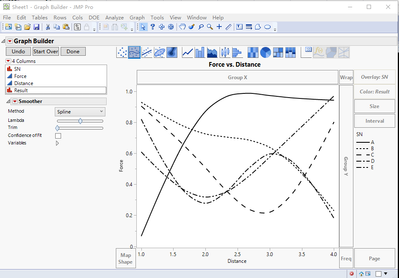

step 3 (the issue I am facing): color by "result" to see the status of NG and OK in the whole plot, but as we can see there is no color to distinguish NG and OK.
N1ck_3-1749363326874.png +
Could you please help to check it? thanks!

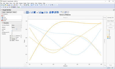

Which JMP version are you using (I'm using JMP18)? As no data was provided this might be slightly incorrect but for me it seems to work correctly

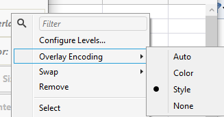

You can also "force" overlay encoding but I don't think it is necessary in this case
