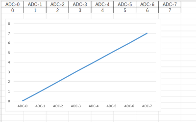

Like, a 8-bits ADC, the output are printed as 8 columns in jmp file, then how can I show data of 8 columns in 1 char. example below.

This chart is from Excel, but I'd like to know how to get similar chart with JMP.

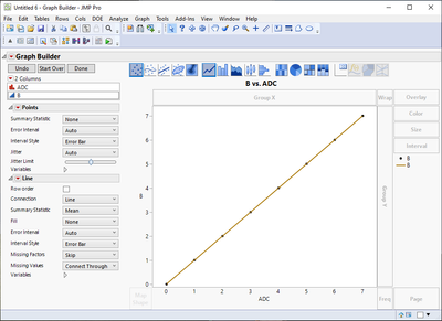

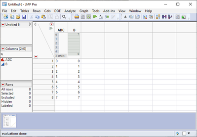

Easiest way is most likely to format your data like this
and then you can plot it

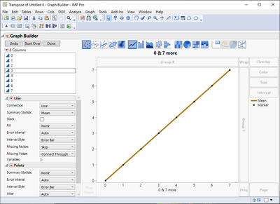

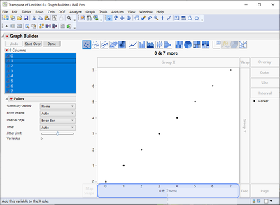

If your data is in this format
You still plot it by selecting all values from Graph Builder and then dropping them to X-axis

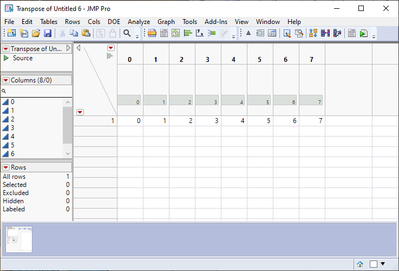

thank you jthi, I'll transpose data to plot that.
