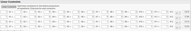

Hence, I tried to set the linear constraint as follow:
I am not certain if my linear constraint is correct

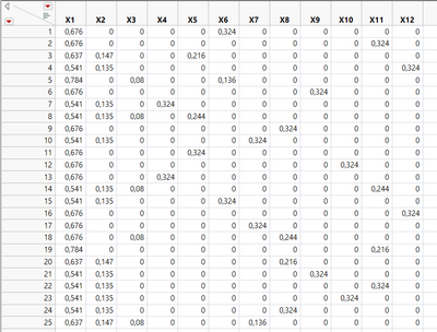

I generated a subset table with 25 trials and realize that most runs will have 0 value in the multiple components. Also component X3 is only tested either 0 or 0.08. I felt that something is not quite right. Is there any advice for me to improve the design?
Your design does what you specified, it explores the edges and vertices of your experimental space (so mostly at the lower and upper levels of your factors), and respecting your linear constraint. Since you have a lot of factors and this design has an emphasis on vertices, most of the factors will be at 0 for each runs, it will explore mostly the borders/edges/vertices of the design, not the inside with more sophisticated mixtures involving more components.
If you're not satisfied with this design, perhaps you could describe more what were your objectives, expectations and experimental budget constraints ?

  1. You can add the constraints the way you intended to do it in your first post (with positive values for factors and inequality constraints >= and =<), it should work, no need to add the constraints with negative values. The negative values writing is used by JMP to handle any inferior linear contraints. In a simple example with 3 mixture factors, I specified that X1 + X3 should be between 0,5 and 0,8 and here is how this constraint is translated by JMP in the table :
    {1 * :X1 + 1 * :X2 - 0.8, -1 * :X1 + -1 * :X2 + 0.5}
    You can see that for the inferior linear constraint, JMP did rewrite it like - X1 - X2 =< -0,5 (or -X1 -X2 + 0,5 =< 0), it's just a way to have the same JMP scripting language writing convention as for the superior linear constraint with the same inequality sign, but you don't need to do it yourself.
    Adding the same constraints with positive and negative values is helpful if you're in a situation of mixture of mixtures, where some components should sum up to a certain percentage (like A+B = 0,8), and adding the rest of the mixture components sum up to 1 (or 100%, like A+B+C+D).
  2. Based on your requirements, I would set up the linear constraints like these :
  3. X3 has a very narrow range (0 - 0,08) so that may explain why other levels are not proposed. Are you sure about specifying an individual (narrow) range for X3 in addition to the linear constraint for X3 to X12 ? Same question for X1 and X2 with their individual constraints and their linear constraint.
    Also you're right, the degree of the design is an indication about the maximum number of mixture factors that can be involved in the experiments (from 1 to the degree). But since your primary focus is evaluating the influence and importance of each mixture factors and the subset selection had a D-Optimality criterion (and you have a limited budget compared to the number of possible combinations), even with a higher degree the subset proposed with a 25-runs budget will put high emphasis on experiments with few components :
Here is the script to generate this design :

And attached you'll find the datatable.
Hope these answers may help you better understand,
Victor GUILLER

(2) Based on the linear constraint from my 1st post, I could not generate the Ternary Plot. Hence, I tried to set 2 more linear constraint and able to view the Ternary Plot. Is this appropriate to set for my experiment design?
My experiment design requirements are:
Combine of X1 and X2 to be in the range of 0.676 - 0.784
Combine of X3 to X12 to be in the range of 0.216 - 0.324
