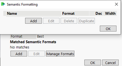

jthi
Re: How to set the decimal point to 2 on all the flatforms?
I think you might be able to utilize Semantic Format for this but I have never used it
https://www.jmp.com/support/help/en/18.0/#page/jmp/semantic-formatting.shtml
