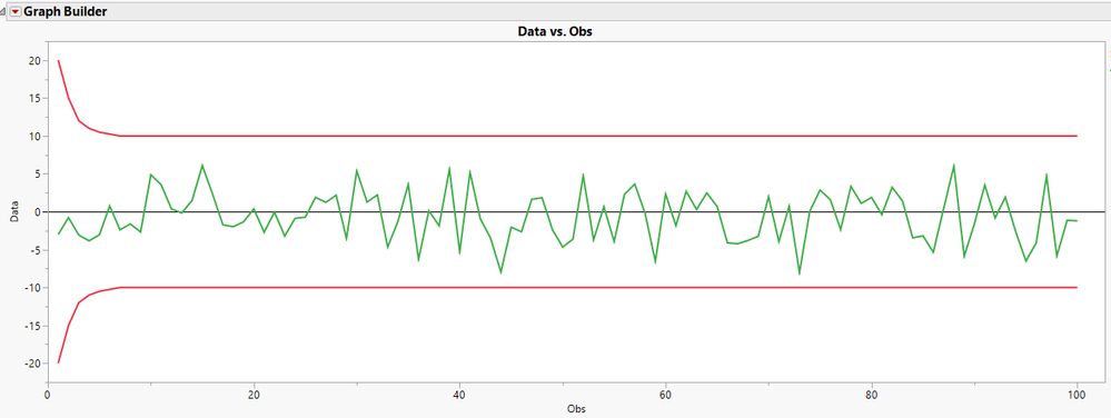

I'd like to produce something like attached with the two red lines being the reference lines changing against X.

This looks like an UWMA control chart.  You can get something like this in Graph Builder if you make the limits of X another series along with the actual data.  Here's what the result looks like.Example.PNGExample.PNG
I made the series for the upper and lower limits and simulated data, then I stacked them to get them into a single column with labels.  See the attached data tables.
-- Cameron Willden

Good idea! this should work for me! thanks!
